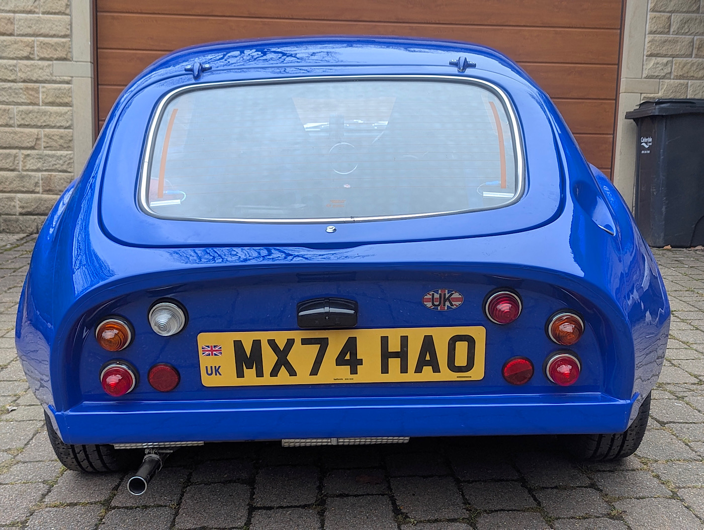

Posted on: January 7th, 2025, 23:10:20
Quote Report to Moderator
Baby Member
Location: Hebden Bridge, West Yorkshire
Posts: 11
I thought I should bring my build log up to date.
After completing a 4 year project from collecting the shell out of the moulds at Marcos Cars in October 2020 I finally achieved a successful IVA test pass in October 2024. Registered to use on the road in December 2024.
Now to start enjoy driving it!
I still have work to do including an engine upgrade, removing the seams and fitting carpets & underlay.

Neil KilBane
Posted on: January 8th, 2025, 11:01:10 Quote Report to Moderator
just a little fine tuning left to do.
Location: Newtown Forbes, Ireland
Posts: 1,423
Reputation: 0 (tot: )
Congrats, great to see another MM on the road.
